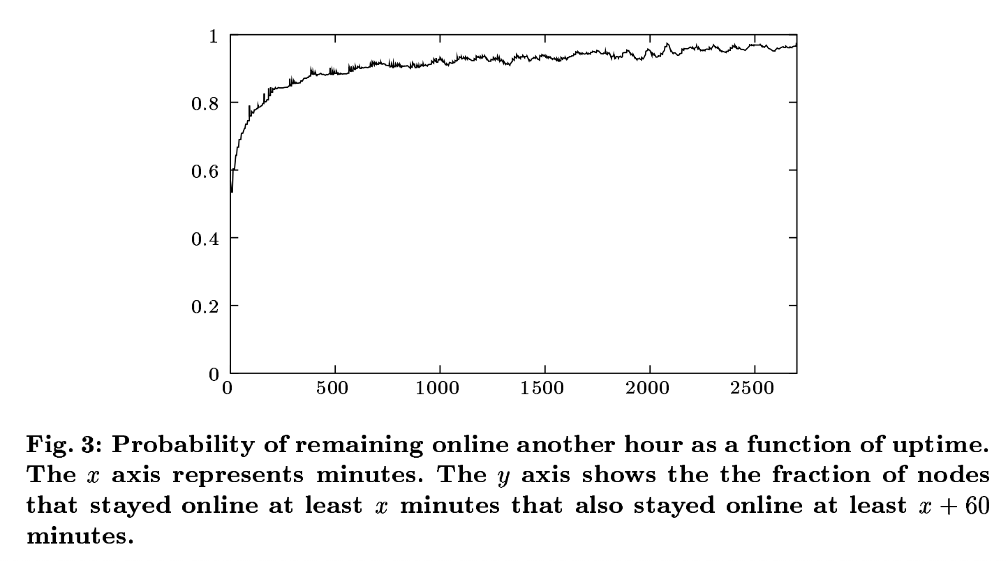

Another advantage of Kademlia is that the protocol naturally prefers long-lived nodes over newer entrants. The figure below (pulled from the Kademlia paper) illustrates the fact that the longer a node has been alive, the more likely it is to remain online into the future.
This preference toward node ‘liveliness’ plays naturally into our distributed storage system where node-churn leads to a scenario where repair costs must be minimized.

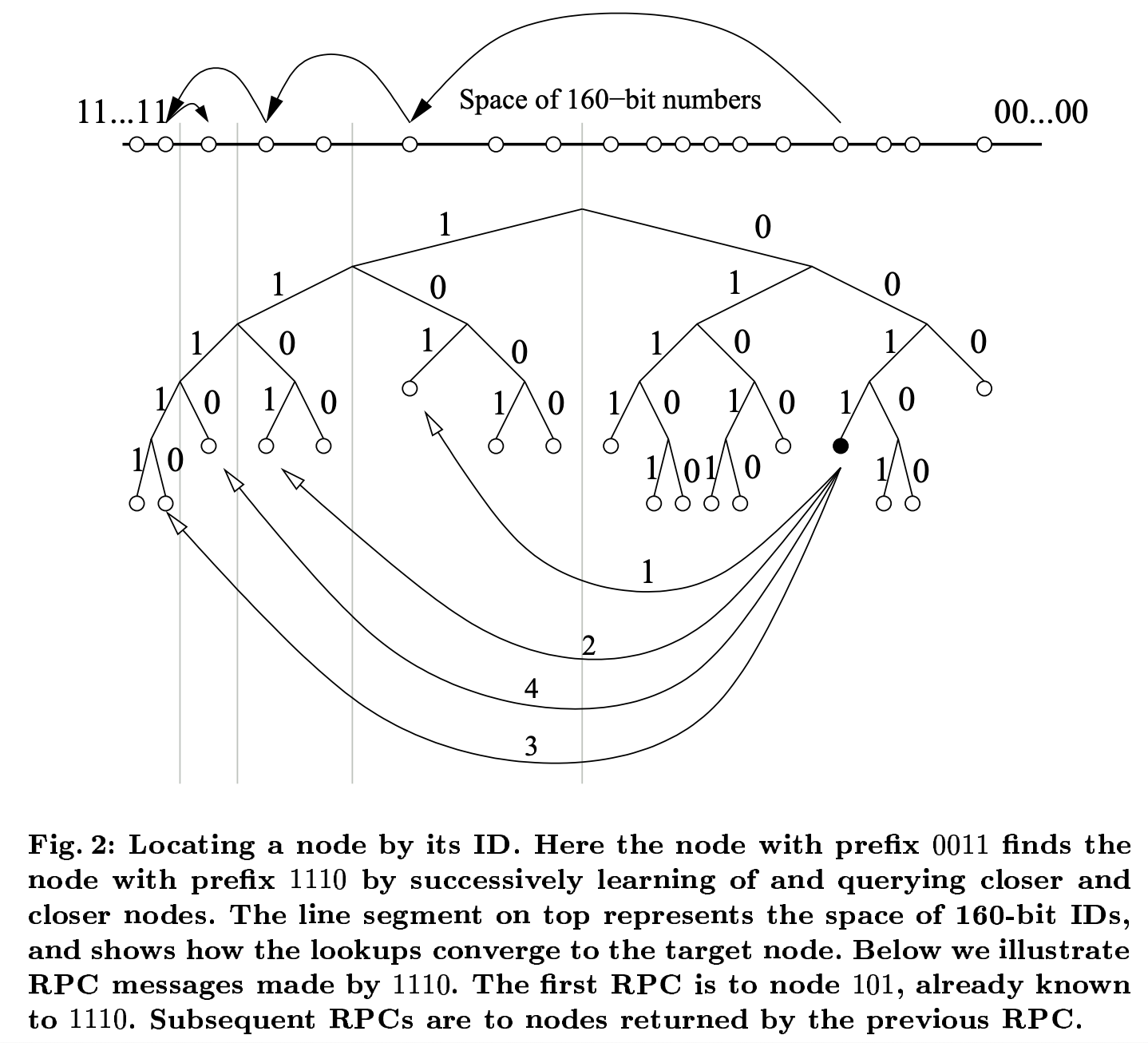

Kademlia treats each node on a network as a leaf on a binary tree. Generally, each Kademlia node has a 160-bit NodeID (SHA-1), and its position is determined by the shortest unique prefix of its ID.
To assign key-value pairs to particular nodes, Kademlia relies on a notion of distance between two identifiers. Given two 160-bit identifiers, x and y, Kademlia defines the distance between them as the XOR.
From a node point of view, the tree is divided into series of successive sub-trees where the 160th subtree contains the individual node. The Kademlia protocol ensures that each node knows of at least one node on each of its sub-trees. With this guarantee, a node can locate any other node by its ID.

The routing table is a binary tree whose leaves are k-buckets. The structure of the Kademlia routing table is such that nodes maintain detailed knowledge of the address space closest to them, and exponentially decreasing knowledge of more distant address space.
The symmetry is useful since it means that each of these closest contacts will be maintaining detailed knowledge of a similar part of the address space, rather than a remote part.
K-buckets are a list of routing addresses of other nodes in the network, which are maintained by each node and contain the IP address, port, and NodeID for peer participants in the system. They prefer the longest-lived nodes, which means that one cannot overtake a node’s routing state by flooding the system with new nodes (thus preventing certain types of DDOS attacks).
