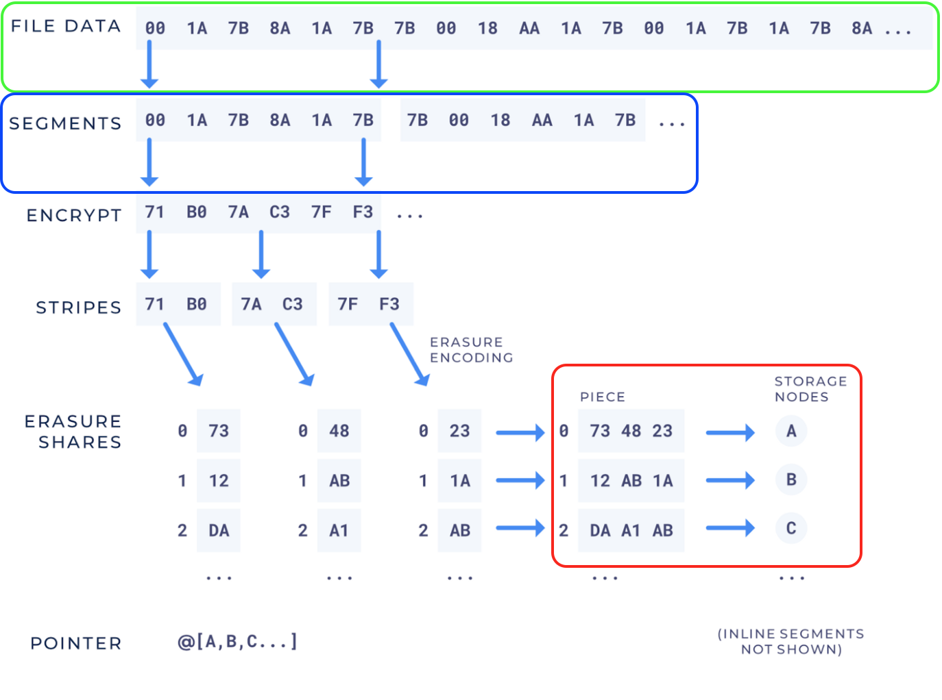

Files -> Segments -> Pieces
  • Files are the items you upload to the network. Files are broken down into segments.
  • Files are represented by the green box in the diagram below.
  • Files are made of one or more segments. Our segment size is 64MB. 256MB is made up of 4 such 64MB segments.
  • Segments are represented by the blue box in the diagram below.
  • Segments are made up of pieces. For each segment sent out to the network, 80 pieces are distributed to Nodes.
  • Pieces are represented by the red box in the diagram below.
